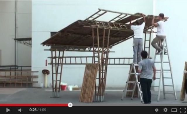

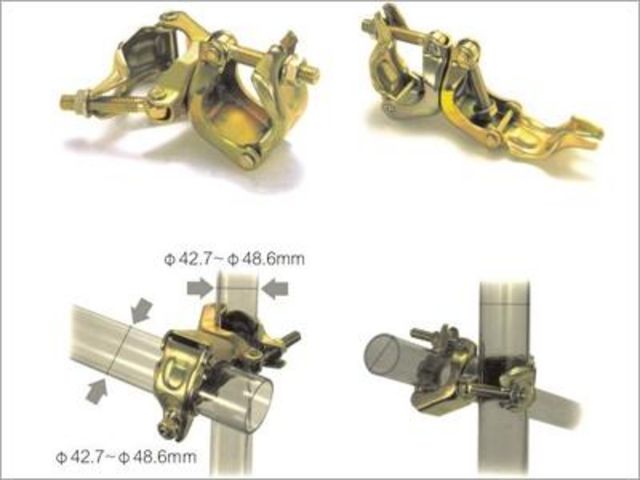

·s¦¡, ¥Î¸U¦V¬¡¦©§Ö³t²Õ¸Ëªººñ¦â«Ø¿v¡u§Ö°{¦Ëò©«Î ¡v:
https://www.youtube.com/watch?v=nmPsA2pSnaY
¥Ý­Z¤u·~¤½¥q¦³: Áú¦¡¸U¦V¬¡¦© (R¨¤90«×)¡B¤é¦¡¸U¦V¬¡¦© (R¨¤105«×)
http://www.hemaoco.com.tw/product.php?cat=280&pid=378
