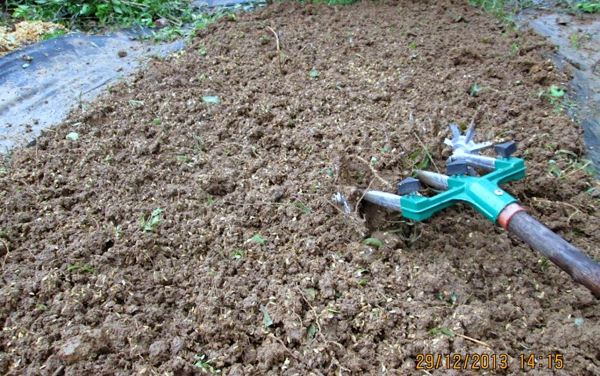

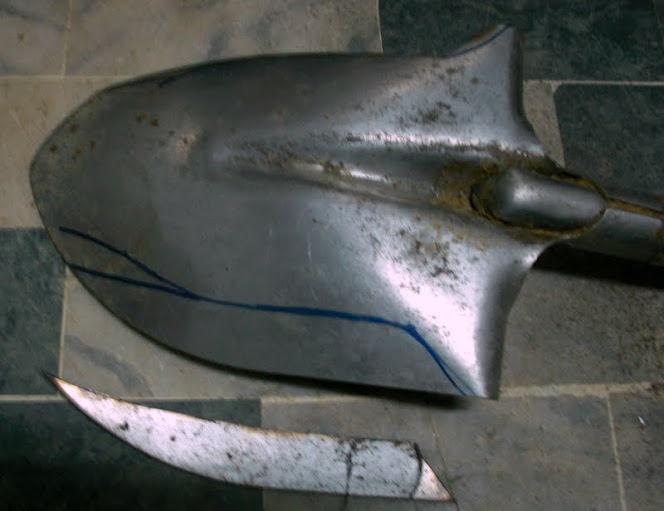

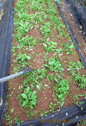

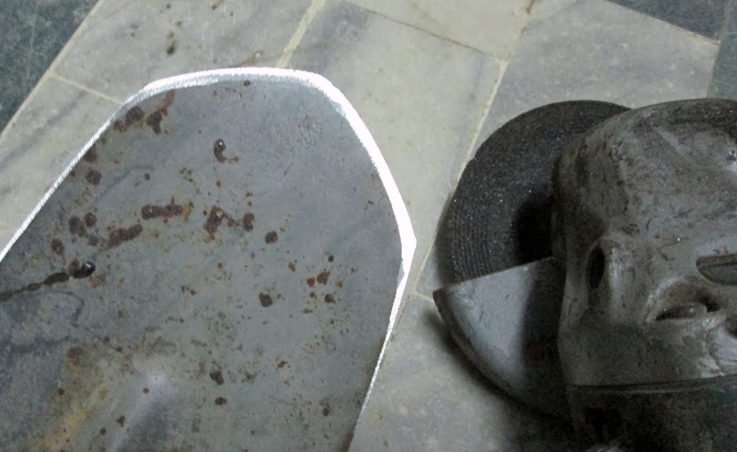

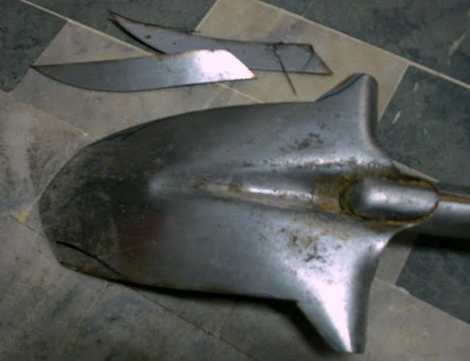

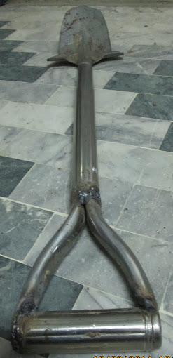

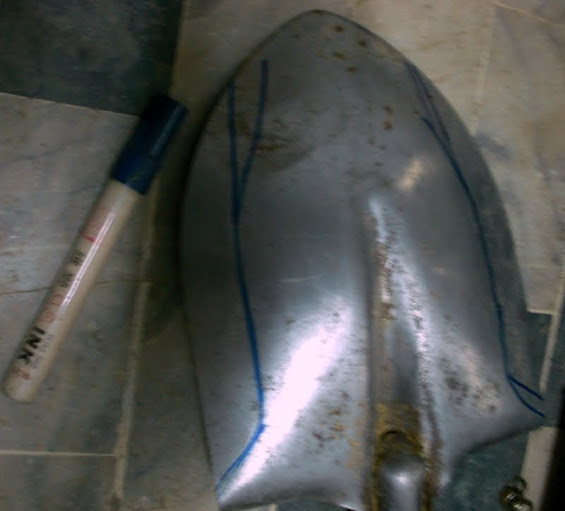

¬Ý¤F³\¦h°ê¥~¤â¤u½¤g¤u¨ãªº¼v¤ù«á...¤Î001¤j¦³DIYªº«e¨Ò...
ı±o¦pªG¥u­nºØ´Ó¤@¤p¤ùµæ¶é,°£¤F°£¯ó«áÁٻݭn¥Î¾SÀY©Î¶êÁ꽤g,¦A±N¤g¶ô¥´¦¨¤p¹Î«á¤~¯à¼½ºØ.
¦]¬°¶È¤î©ó¤p­±¿nªº¯ÑºØ,©Ò¥H§ó¤£¥²±þÂû¥Î¤û¤M¥h°Ê¥Î¤p¤û
©ó¬O¿³°_DIY¼Ò¥é¼v¤ù¤¤ªºÂ½¤g¤u¨ã,¬Ý¬O§_¤@Á|¨â±o---¬J¯à½¤g¤S¯à¦¨¬°¸û¤p¤g¹Î,¥H§Q°¨¤W¼½ºØ©O?
¥þ³¡§÷®Æ¤@¦¸´N¦bf¤j³B§ä»ô¤F!...
¸ÓÆp¤Õ¸Ó¤Áµuªº´N¤U¤â¤F!
¥ýÏb¥X¤@­ÓÂú«¬...
¦]¬°¬O¸ÕÅç©Ê½è©Ò¥H¥H¼e«×30CM¬°·Ç
¬¡°ÊºÝ¥ß¬W
ÂùÃä¥ß¬W¿N²k©T©w
²Õ¦X¥[¤W§â¤â±ì

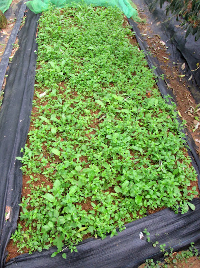

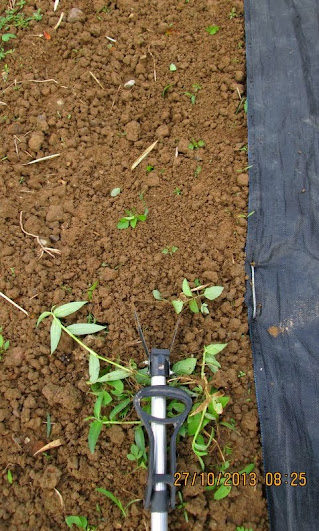

§@ªÌ: eastern    ®É¶¡: 2013-10-21 08:46
¸Õ¥Î¤ß±o³ø§i:
·í­n±N¤gÄ[¤W«õ³q¹L¥ß¬W®Éªý¤O¼W¥[,©Ò¥H·|§â«eºÝ©T©w®y¾ã­Ó©¹¤W©Ô...
¥²»Ý¥H¸}½ò¦í«eºÝ¤@¨¤,¤~¯à¶¶§Q±N¤gÄ[¤W«õ
©Î³\ÄÝ©ó¸ûÂH¤g½èªºÃö«Y§a!
¥þºÚ¾ã¹L¤@¦¸«áªº±¡´º...
¥i¥Hª½±µºØ¤U°ªÄRµæ­]¤F!...

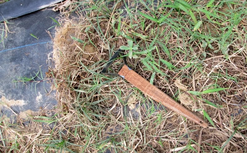

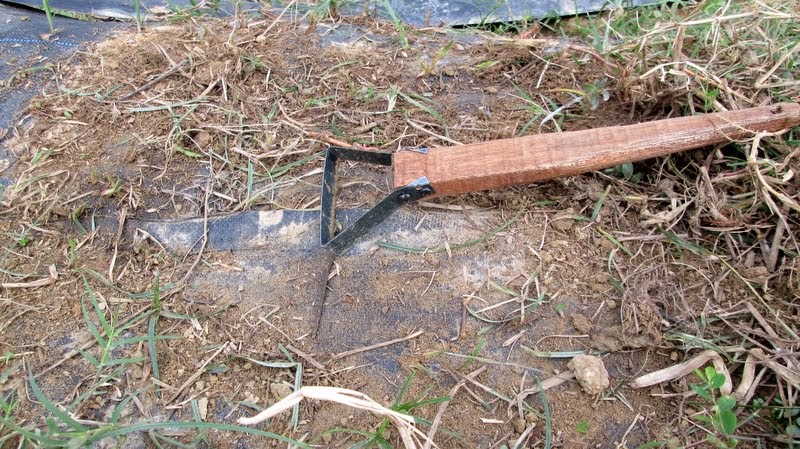

«e¨¥: ¤]¬O¦bºô¸ô¼v¤ù¬Ý¨ìªº³Ð·N¤u¨ã,®³ÅK±ø¥´¥]±a»s¦¨¨í¯ó¤u¨ã
©ó¬O¬Q¤ÑÃM¾÷¨®±H³f¦^µ{,§Ï©»À£¹L¤@±øÅK±ø¥´¥]±a...
¤£¦º¤ß¦^ÀY´Nµ¹¥¦¦b¸ô¤¤¥¡,§CµÛÀY¾ß¦^¨Ó
´N¬O¥¦...
§ä¥X¤@¨Ç§÷®Æ
±NÅK±øÏb¦n¥~§Î¤ÎÆp©T©w¤Õ,¿÷¤@¬q¤ì¤â¬`...
·Q»¡ª½±µ¥­¥­ªºÂê¤WÁ³µ·§Y¥i?
«á¨Ó·Q¨ì©Î³\¦³¨Ç©·«×¨Ï¥Î°_¨Ó·|¤è«K¤@ÂI
©ó¬Oµ¹¥¦³ì­Ó¨¤«×,­«·s¦AÆp¤@¤Õ¨Ó©T©w!
§¹¦¨°Õ!
¤â§@¨í¯ó¾¹...´Nµ¥¸Õ¥Î¤F!...

Ä~Äòµ¹¥¦§ï¤U¥h...
¤@¤äÃa±¼ªº®ü´Ö©ì§â¬[+ÅK±ø...
¦]¬°§Æ±æ¯¸µÛ¤]¥i¥H¨Ï¥Î,¨ä¥Lªº¦p¾vªw»s...

¨ä¹ê³o­ÓªF¦è, §Ú¤ñ¸û³ßÅw¥s¥¦¨í¯ó¤M, ³Ì¥D­nªº¥Øªº¬O--
°£¯ó¥u¶·¥Ñ¦aªí¤U1¤À³B¤Á°_¡A¤Á°£¯ó¤§ªÞÂI¡A¦a¤U¤§®Ú´N¤£·|¦Aµo¡A¨Ã¥ß§Y±H¨Ó¤@§â¦aªí¨í¯ó¤M¡Aªø¬`¤H¯¸¥ß¾Þ§@©ö¨Ï¤O¡A«e«á¨â­±¤b¤f¡A«e±À«á©Ô³£¯à³s¤g±a¯ó¨í°_¡C
source--http://yangpy.pixnet.net/blog/post/36840468
¤£¹L, ¦]¬°¦b¨í¯ó®É, ¨í¥Xªº¯ó»P¤g·|¯d¦b­ì³B, ¬Û·í©ó¦³ÃP¤g§@¥Î...., ¥u¬O, ¥¦¬O²L¼hªºÃP¤g...
¯ó¤Ó±K®É, ¤£¦n¥Î. ³Ì¦n¥Îªº®É¾÷¬Oµæ®E­n´«§@ª«®É.....

§@ªÌ: eastern    ®É¶¡: 2013-10-29 10:59
eastern µoªí©ó 2013-10-24 09:07
Ä~Äòµ¹¥¦§ï¤U¥h...
ªøªº³o¤@¤ä¥i¥H¥Î¨ÓÃê°£¦a¤Wªº´²¸¨Âø¯ó...
¾A¦Xµæ¶é½­µæ¦¨ªø´Á¶¡¤§Âø¯ó²M°£...

§@ªÌ: eastern    ®É¶¡: 2013-11-4 13:41
½¤g¾¹µ¹¥¦©î¦^¨Ó,¼W¥[¨â°¼¸}½ñªO...
¦A¸Õ¥Î¬Ý¬Ý...
¸û¾A¦X°®µw¾A¤¤,¤£¤ÓÀã³n¤Î¤£¤Óµw¨¹¨¹ªº¦a...
³o¤@¬q«õ¤@«õ´N¶¶«K±N«n¥Ê­]µ¹ºØ¤U¥h°Õ!

§@ªÌ: eastern    ®É¶¡: 2013-12-30 13:24
¥»©«³Ì«á¥Ñ eastern ©ó 2014-1-1 19:17 ½s¿è
viser.chen µoªí©ó 2013-11-7 16:19
eastern¤j: 2home«Ü¦h¹³§A­È±o§Ú³o¦×Âû¾Ç²ßªº¦a¤è¡A·PÁ½Ѧ쪺¤À¨É !
¯óªøªº¸òµæµæ³£¤À¤£²M·¡°Õ!
¨ú¥X¤W¦^¨º¤@¤äµ¹¥¦­Ì­×²z¤@¤U喽!...

³sÄò«B¤Ñ·Q¾ã¤gºØµæÁÙ¯u¨¯­W
¦]¬°¤g¶ôÂH¾SÀY¤]ªg¶êÁê,¤Q¤ÀÃø¤U¾S...
©Ò¥HÁa¨Ï«õ¦n«á,³£¬O¤@¤jÌ@¤@¤jÌ@ªºª¬ºA...
©ó¬O·Q¨ì¤§«e¶R¨Óªº§Q¾¹,µ¹¥¦¸Õ¸Õ¬ÝÐù!
¨Ï¥Î«e:
¾ã§Î«á:

eastern µoªí©ó 2013-12-30 20:04
³o³Ã¥ë¦n¥Î¶Ü?
§Ú®a®ÇÃ䤧ªÅ¦a,¤g´X¥G³£±K¹ê
§Ú·QÃP¤gºØ´XÁû¦Ê­»ªG
§@ªÌ: eastern    ®É¶¡: 2014-1-1 19:26
smallgiral02 µoªí©ó 2014-1-1 19:01
³o³Ã¥ë¦n¥Î¶Ü?
°ò¥»¤WÁÙ¬O­n¨Ï¥Î¶êÁê©Î¾SÀY¥ý«õ±¸Â½°_¸û²`ªº¤g¼h
³o¬P§Îºu½ü¤u¨ã¥u¬O­n±Nªí¤g¤Ó¤j¶ô¤Ó²ÊÁWªººu¦¨²Ó¿°¨Ç
¤è«K¼½¼»²Ó¤pºØ¤l®É,ºØ¤l¤£·|³´¤J²`³B¤£¨£¤F!
ºØ¦Ê­»ªG¥u­n±N¨C®èª½®|¬ù1M¤gÄ[¹w¥ý±¸ÃP²V¦X¨Ç¦³¾÷ªÎ
À³¸Ó´NOK°Õ!...

¤@¤ä¥|¤­¦Êªº¤p¶êÁê´¤§â¤w¸g²k­×¹L¤@¦¸,³o¦¸¤SÂ_¤F¤@Ãä...
·Q»¡¶X³o¦¸­×´¤§â¶¶«K±N¶êÁ곡¤À­×§ï¤@¤U¦n¤F!
§Æ±æÅܦ¨ªG¾ð¬IªÎ¥Îªº§Q¾¹...
¤ÀÂ÷ªº´¤§â¤]µ¹¥¦²k°_¨Ó¤F!
«eºÝ¦A¿i§Q¤@¨Ç,«õ²¾¾ð¤ì®É©Î³\ÁÙ¥i¥HÂ_®Ú¨Ï¥Î!...

¥¢¦Ó´_±oªº¥j¸³§â¬`...

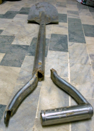

¨º¤Ñ¥Î¤p¤û½¤g®É,½¥X¨Ó¤@®ÚÃþ¦ü³¯¦~¥j¸³§â¬`...
·í®É¬O»qº¡ªd¤g¥Íù×·¥¤F!...
¥»¥H¬°¬O«e´Â¿òª«...´N±N¥¦¥ý¥µ¦bªá¬ÖÃä,¦Ü¤Ö¬O­ÓÅK¾¹¥i¯àÁÙ¦³¤@ÂI»ù­È¹À!...
¹L¤F¤@¬q®É¤é«á...,´N¦b«e¤Ñ¨Ï¥Î§¹¤p¤û«á,¶¶«K²M²z¤@¤Uªþ¦b¤WÀYªºªd¤g
µo²{«ç»òªý¤O±ì¤W­±ªº½Õ¾ã§â¬`¤£¨£°Õ!...
³o·|¨à¤~¦^¯«¹L¨Ó...­ì¨Ó¤§«e¾ß¨ìªº¥j¸³,¨Ã«DÄ_ª«¤]!
¦Ó¬O...¦Û¤v²æ¸¨ªº½Õ¾ã§â¬`,¦ý¬O¬°¤°»ò²æ¸¨¤F©O?...
­ì¨Ó¥¦¥u¦³¬ï¹L½Õ¾ãÁ³µ·¦b§ÀºÝµ¹¥¦À£«ó,³y¦¨¤@¨ÇÂØ¦×Åý¥¦·È¤£¥X¥h½}¤F!
¦ý¬O¾Þ¤[¤F...®¶°Ê+¿iÀ¿...¦ÛµM¥¦´N°k²æ¤F!
±a¦^®a¦Aµ¹¥¦¦XÅé§a!
©Î³\¦Aµ¹¥¦¾Þ­Ó¤­¦~¤Q¦~...
