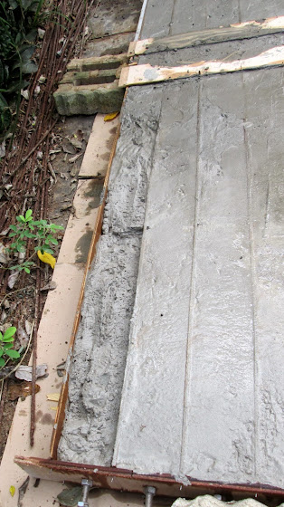

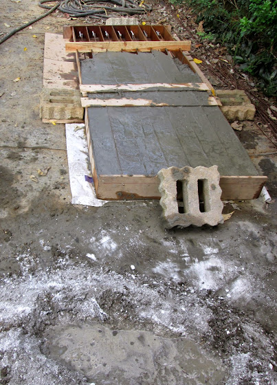

DIY¤ôªd¬W (¤U)
¨S¦³Åͩվ¹¥u¦³¤@Âù¤â,©Ò¥H¤@¦¸¥u¯à½©Õ¬ù1/3-1/4¥]¥÷ªº¤ôªd...
¦]¦¹©Õ§¹²Ä¤@¦¸¥ý±N¤ì¼Ò³s±µ³B¶ñ¥R¤@¤U,Á×§K¶}ªáÅܧÎ...
«z! ©Õ¤F¦Ñ¥b¤Ñ³ºµM¥u¯à¶ñ¥R¨º¤@ÂIÂI­±¿n
²Ä¤G¦¸©Õ§¹¤ôªd¤]¥u¯à±N©³³¡¶ñº¡
²Ä¤T¦¸±N©Ò¦³§÷®Æ¥þ³¡©Õ§¹«á,¤´µM¯Ê¤F¤@¨¤...
ÁÙ¦n«Ø§÷¦æÃM¾÷¨®´N¥i¥H¨ì¹F,¥ß°¨µ¹¥¦¶R¤ôªd¤Î¬â¦^¨Ó...Ä~Äò½m!...
¶¶«K±È¶}¤¤¬q»Î±µ©T©wªO¸Ì­±,¸É¨¬¯Ê®Æ...
¦p¦¹³o¯ë...Á`ºâ§¹¦¨­º¦¸ªº¤ôªd¬WDIY¤F!...
