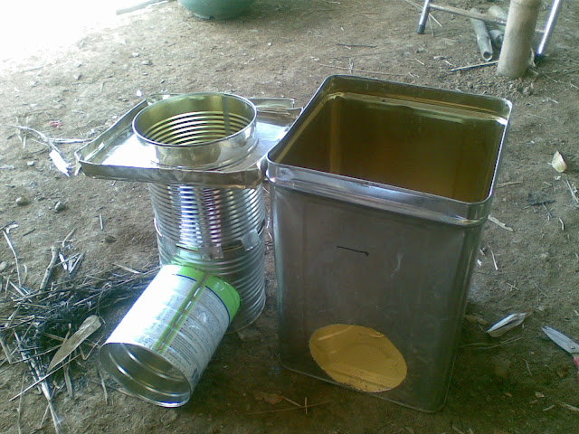

µoªí©ó 2010-10-7 18:59:31 |¥u¬Ý¸Ó§@ªÌ.....¸ü¤J¥þ³¡¹Ï¤ù ¥ÎLINE¶Ç°e . ¤À¨É¨ìFB
~~~«Â¤j£°....
~~~¤W¦¸¨ì§A®a(©_³¡)..¬Ý¤F«Ü¸Ô²Ó»¡.....
~~~¦]¬°§Ú¤j³¡¥÷³B²zµ«¤l¦ÓÁç¤l¬O²`±í¾TÁç...
~~~¤@ª½¦A·Q·d¤@­Ó¨Óª±..¥u¬O³oµ²ºc¥²¶·¦A­×§ï!
~~~4¤o¿ûºÞ©Î¬O20kg¥Ë´µ±í¤j¤p..(¤º®|40cm)
~~~¥~®|¨Ï¥Î²[¬}³B²z...¤ì§÷¤Ó¦h..·Q¿ìªk³B²z±¼..
~~~¤£¹LÁÙ·Q°µ¤@­Óô±a«¬..²³æ¤@ÂI..§Ñ°O±a¤]¨SÃö«Y..
~~~¦A»¡¥Ë´µ¶Q..³¥¥~¼o§÷¦h..¦h¨ìÀH«K¦h¦³..
~~~¨Ó¥h°µ¤@¶W¤p«¬¼Ë«~¨Óª±ª±¦n¤F...¦³ÂI·dÀY
~~~¦A¨Ó¥Î¿ûºÞ(3mm)«p¦Ó¤J¤f°µ¥|¨¤«¬...
~~~¤õ¤f°µÀ£ÁY¶ê§Î¤º§tÄl¬[(¤@Å馨«¬......³o¼ËÀ³¸Ó¥i¦æ!..
ªþ¹Ï:·Q³o¼Ë³B²z
1.
